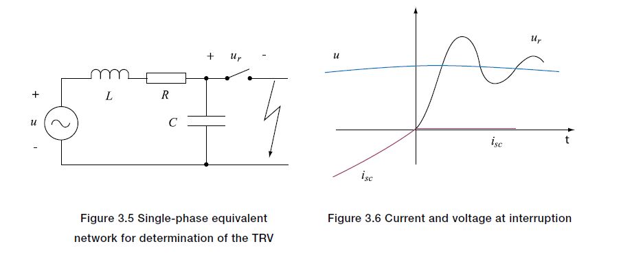

20 sep 2015 19:38 - 21 sep 2015 04:36 #18 av Michell Martic
Hittade nedan text och bild.
Figure 3.6 shows the current and the voltage at interruption of the current. The circuit breaker will only interrupt the current at a current zero. At this instant the supply voltage u of the network is close to its peak value, since the circuit is almost purely inductive. The voltage across the circuit breaker is low (equal to the arc voltage) as long as the current has not been interrupted. After interruption, this voltage will approach the value of the supply voltage through a transient oscillation with a frequency determined by L and C of the network. The overshoot will typically be of the order of 40 - 60%. (Had the circuit been entirely without losses, R = 0, the overshoot would have been 100%).
The voltage across the circuit breaker after interruption is called the recovery voltage. The first oscillatory part of it is referred to as the Transient Recovery Voltage (TRV), while the later part is called power frequency recovery voltage. The power frequency recovery voltage is equal to the open-circuit voltage of the network at the location of the circuit breaker.
Both the Rate of Rise of Recovery Voltage (RRRV) and the peak value of the TRV are important parameters. Together with the magnitude of the current, these parameters determine the severity of the switching case. The ratio of the peak of the TRV and the peak of the source side voltage is called the amplitude factor.
Och denna text bekräftar bara det ni skrivit. Jag har inte gjort skillnad på nätverkets spänning och potentialskillnaden över brytarens kontakter, Vilket jag nu förstår måste varit det du menade tidigare Torbjörn. Jag förstod det inte då bara.
Av denna text att döma så verkar det dock som att den återvändande spänningens derivata beror på nätverkets spännings aktuella storlek och fasläge relativt brytarens aktuella spänning och fasläge. Över brytaren så har dock fasvinkeln konstaterats vara 0 i brytögonblicket vilket innebär att det som är helt avgörande måste vara nätverkets spännings läge och amplitud.
Detta gör att jag vill dra slutsatsen att desto högre û och desto högre induktans jag har i nätet, desto större är nätverkets spänning i brytögonblicket. Och desto större delar av induktiva och kapacitiva komponenter jag har, desto kraftigare oscillation kring nätverkets spänning kommer jag få. Ökad andel reaktiva komponenter kommer således öka risken att jag får en återtändning. Det skulle också förklara varför man har två, eller fler, brytare i serie vid högre spänningar då detta delar û med antalet brytare och därmed minskar risken för återtändning lika mycket.
